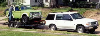

you will have no trouble at all towing your RX7. i tow with my 96 5liter all the time, and with much heavier loads than that. as far as i know, all 5.0's came with a factory tranny cooler. later on, get the Baumann shift kit and install stage 3 (the kit goes from 1-5). this will also extend tranny life while towing, and stage 3 is not very harsh. here is my X (before the wheel change) towing my 75 bronc...
