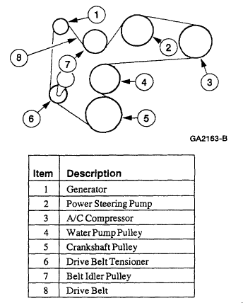

Please be more specific about which pulley. Further, a picture would be nice.
Ok, so you are looking inside your hood...
Then there is the tensioner to the very left, then the idler in the middle, then the grooved pulley t othe right of the idler. This is the pulley I am talking about. I don't know what this is for. But this is the one that I can PULL OUT approx 2milimeters in and out...
Next to the above pulley, is what i guess is the AC pulley (it has grooved outer pulley and inside wheel that spins separately).
Which one?
When i pull on the AC compressor pulley, it does not move at all. Idler does not move either. Neither does tensioner.
Only the #2 pulley can be pulled out 2mm, then pushed back... I looked to see if the pulley was bolted on or something. But it looked like it was a single piece with the power steering thingy that is attached to the pulley
I don't have the pic, but it's #2 from your diagram. I can pull it out 2mm and push it back. Back and forth easily.
