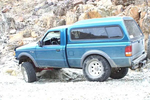

I did a 2" body lift on my Ranger (with plenty of rust) which I bought in Lansing, MI back in '96. The install was a pain in the neck, but 12 hours later, I was ready for the trail.
Once the body lift was complete, my stock bumper had this huge gap that was unsightly, and made the truck look unfinished. Whats worse, is I have a receiver hitch (drop down) - so, if I spaced the bumper up, then, I'd have this hitch sitting real low. I could swap out the hitch for a hitch that comes straight out rather than drop down, but instead I purchased a Smittybuilt tube bumper with the filler plate. This combo filled the gap completely, and you'd never guess that I have a body lift. Here is a photo of the rear of the truck - which has a 4" lift (front) and a 1.5" lift (rear) from add-a-leafs from my Rancho suspension. The tires tuck nicely into the fender wells with 33's, and although I'm getting new rear springs (when I have the money), my stock springs w/add-a-leafs flex very well...
yeah, i will get pics of my bumper tomarrow. it looks horrible even with the brackets. i am starting to look at getting a new one, maybe one with a tire carrier.

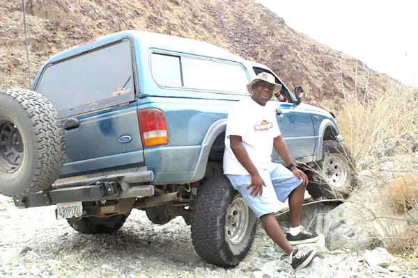

The Smittybuilt bumper that I have swiveled upward upon installation, making the gap completely unnoticable. The tire carrier was fabbed into place using bars that connect to the frame, and two flat mounts - cut out of steel bar stock.
If you want to run a tire carrier, just get yourself some rectangular steel bar stock, cut it to the length of your frame, and weld some connectors that will locate the bumper to your frame. Then, drill the holes to attach your Jeep-style tire carrier and you're done. Maybe replace the dropdown hitch receiver with one that comes straight out - to preserve your departure angle...
For a lack of a better picture:D Here's me next to my truck. Check how the square tubing was fabbed in place outside of the tube bumper. Steel forks attach to the frame, and also attach to the inside of those steel rectangular mounts (thru some holes in there). I can email you detailed photos of the whole installation so you can see what I mean. Anyways, here's me with my 180,000 '94!
