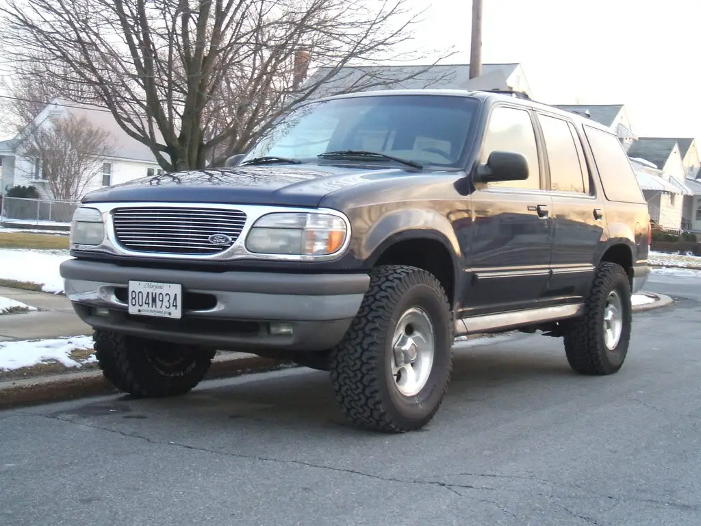

im running a tt in the front for 2" and an add a leaf and shackles in the rear for 2"...everywhere i read says you can run a 32X11.50 15 with some trimming or it might fit snug.....
im currently running 32/11.50r15 on stock expo wheels and i have plenty of clearence and never rub....and yes my lift is only two inches...i made sure as not to go over to tear the front end to hell.....
now my problem and question is what is the actual measurement diameter for a 32 11.50 15. i look online and they all say from like 31.5 inches to 31.7 inches ill buy that as a 32...but my tires only measure out to like 29 3/4" ground to top and around 30 1/4-1/2" side to side when mounted on the expo with correct pressure. that measurement and what the sites tell me would make me think i should have no tread left at all.
ive still got a ton of tread left...and don't believe i took off more then a 1/2 inch of tread on each side in less the a year and only 8000 miles at most. i just want some opinions before i do my 2 " body lift.. as what actual size tires to buy im not going to buy a 33 if thats only gonna measure to like 31 and some inches.......when all the sites that say my 32 should be right tell me a 33 should be over 32 1/2
Anyone got any input on this:D of maybe someone could measure a 32/11.50 thats relatively new on there truck and tell me what they get?:thumbsup:
ohh and my tread depth is roughly 12/32's of the 17/32s new so that only account for just over a 1/4 inch of diameter loss
thanks
so best bet to just out right measure new tires before i buy them-lol?
they look alot bigger then my general grabber AT-2's 31x10.5
