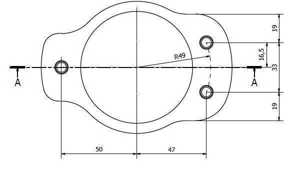

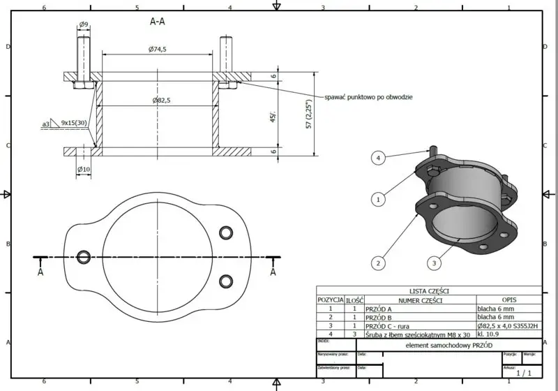

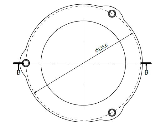

Attached drawings for those who want to do it themselves - Ford Explorer 2004
Serious Explorations Explorer Forum Ford Explorer and Ranger Enthusiasts
Where are the dimensions for the stud/hole locations, and overall shape?
I can't add dxf files, the forum does not provide this option for my user
dxf file are only ready for laser cutting w/o dimension, e-mail address priv please
