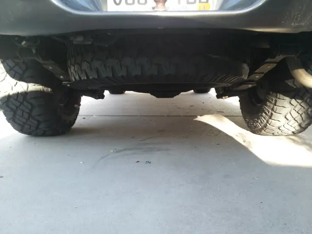

Went to a local used tire shop, and they had an older used BFG AT 33x12.5xr15 (half tread or so) for $40- so I got that and stuck it up under the bed , on a 5th Cragar Soft 8-
Here it is- I'm thinking about doing the tongue bending thing to get it up under there a bit further.
I do plan on putting a rear hitch on someday, I hope it works with that as well.
