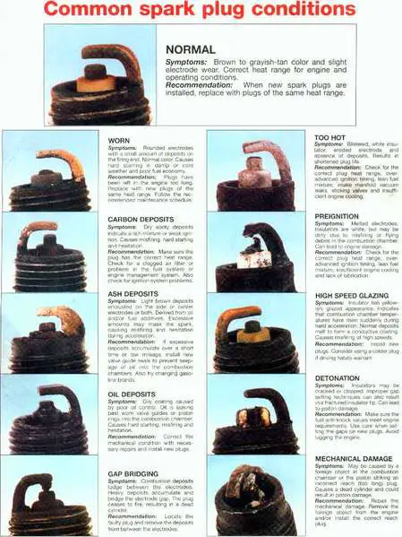

What kind of condition were the spark plugs in?
I don't know yet. It's still in the shop. I just called and asked them to save the plugs as I believe they are original. They also mentioned that the wires are rock hard and they've literally destroyed them trying to get them off.
It'll be interesting to see the plugs!
OK. I got the van back from the shop along with the plugs. They were in fact the original Motorcraft plugs. The color of the 'burn" looked pretty decent all things considered. Light brown to tan color.
Gaps. They ranged from the smallest at 0.069 to the largest at 0.090.
