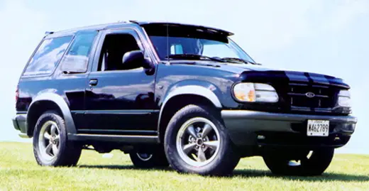

Brought the rims home yesterday, cleaned the he!! out of them today so they're good to go. I even got a compliment out of Mr.-"sport-trucks-are-stupid" LizardTrac, (who met me for lunch up in NY when I went to pick them up), so you KNOW they're in good shape! In case anybody cares, those Mustang center caps pop out very easily from behind-just pull out the ring inside the tabs and push.
Now to get the tires....I've visited a few places and I'll know tomorrow what I'm getting, depending on who has what ;) Wish me luck! :)
Okay, gang...sorry it took me so long, but here they are!

nice spas! where are the centercaps?
close up.....that's some big honkin' rubber on there, lol

welllllll, WillieChu is looking into having some 'GT' center caps made for me, but so far no word :( If anybody has any idea where I could find something with 'gt' or just plain black I'd be VERY grateful!!!
