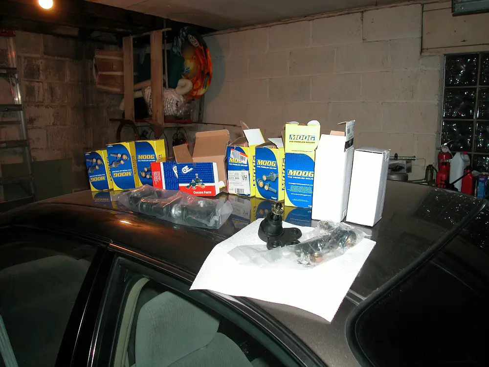

So a few days ago I picked up all the parts for the Oldsmobile.
Parts List:
Hub Bearings - 2
Lower Control Arm Bushings - 4
Lower Ball Joints - 2
Outer Tie Rod Ends - 2
Stabilizer Bar - 1
Stabilizer Bar Bushings - 2
Stabilizer Bar Links - 2
Beer - 48
The Parts:
