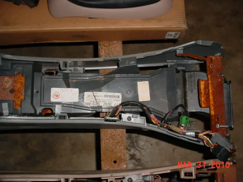

Can't view the photos without joining up. I'm assuming you have the full length console from your description. You have to push in on the sides of the gray cupholder to get it off.
High Series Console R&R That Step #6 is tough. I beat mine until I thought I would destroy it before I got it to move. Hopefully you're not removing the whole console.
If you want more photos PM me your email address and I'll send them. There are more of them than I care to host & post.

thanks for the help, the PDF file is very helpful, I'll tackle it this morning....
Pulled tray to expose center console, tightened a tiny screw/bolt in rt front of console, near passengers feet area, that should take care of the squeak.
