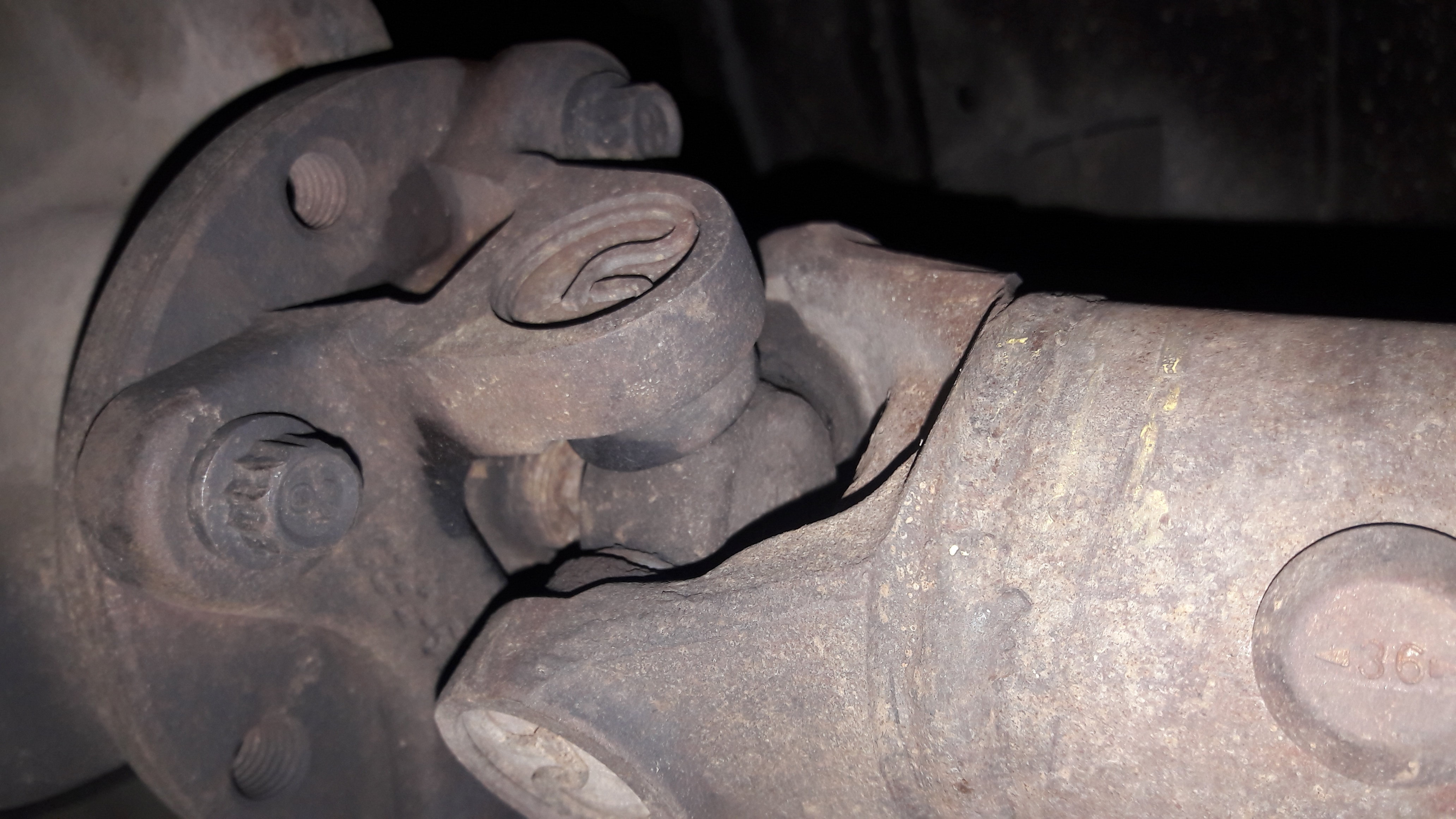

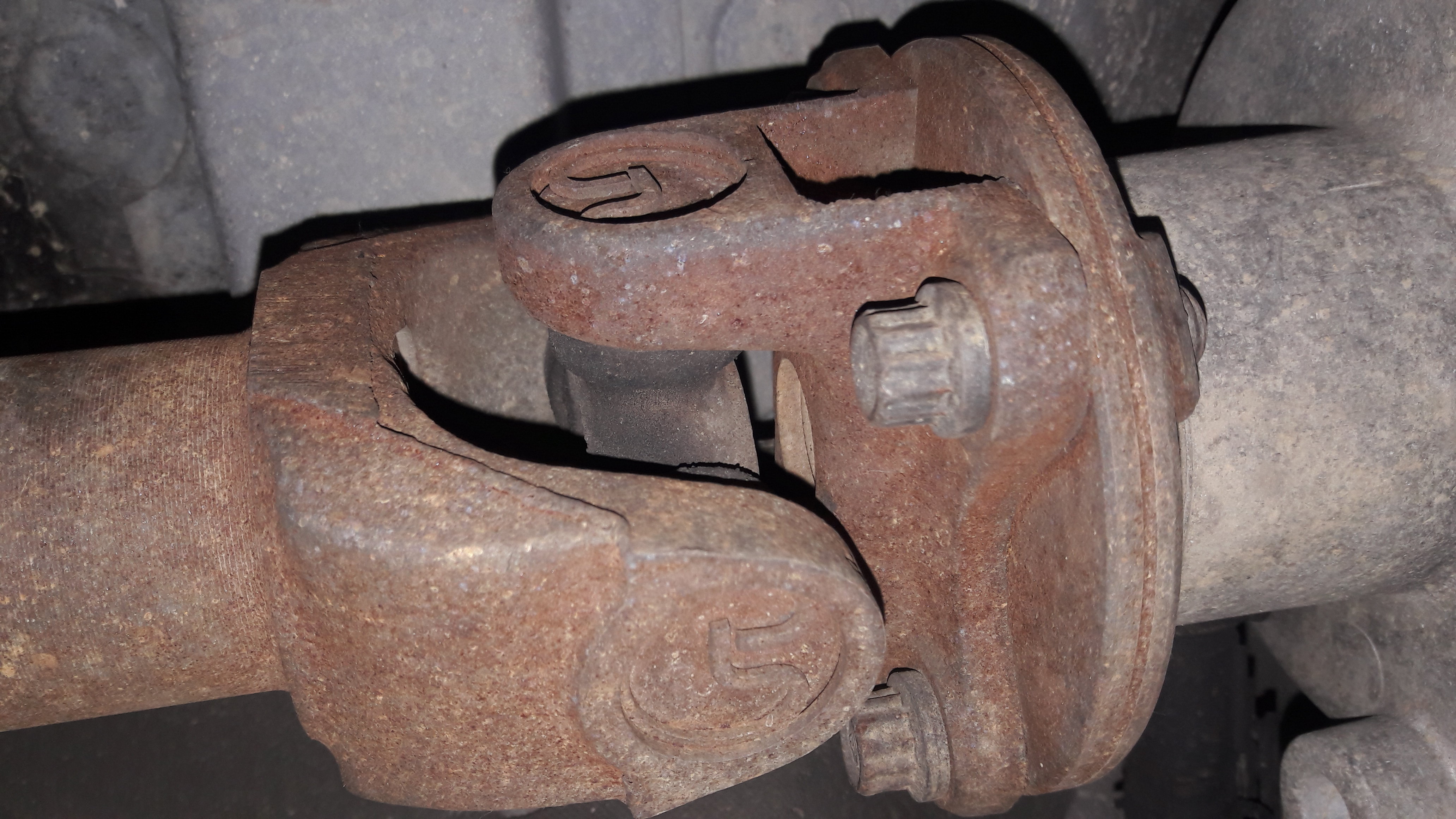

Now i bought this explorer back in October and i havent used the 4x4 at all ive just kept it in rear 2wd. So if it is the u joints id be safe to say that its one of the rear ones i am guessing. I did recheck the rear driveshaft and there was play. I must of been oblivious to it before when i checked.. What i did which is what was suggested earlier and grabbed onto each side of the u joints and gave it a real good twist. There was most definitely play where the boot was (1st pic) in the middle of the shaft. There seemed to be play with the u joint near the transmission (2nd pic). The u joint near the rear seemed to be nice a tight (3rd pic). I couldnt feel any play trying to move the driveshaft up, down, left or right. I took and upload pics of the joints for the hell of it maybe you guys will notice something i cant.
Now the noticeable looseness at the boot in the middle of the driveshaft is a u joint or is it something else? I ask because of the boot and why they would put that on there and not on the other ones. The transmission joint seemed loose but it was hard for me to tell. But if whatever is in that boot is suppose to be tight than im guessing thats my issue.
EDIT: This might be unrelated but ive noticed its been a little more difficult for me to get into low gears lately and ive also been getting some grinding going into first and into reverse. Would this be related since its the transmission driveshaft u joint or am i just having transmission issues also?

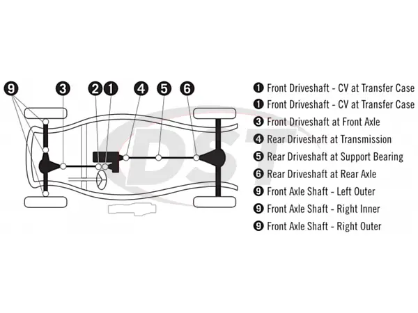

That boot is what covers your slip yoke. It is splines that go together with female splines so that as your suspension moves, the driveshaft can expand or contract. The splines are supposed to have a blue teflon coating, and be greased periodically beyond that. If it's been neglected for 25 years, I'd guess that Teflon coating can be worn down. I don't think I've ever noticed play from one, so something may be wrong. Are those 2 pictures of the axle side u-joint, or do you only have a single u-joint at the transfer case? If you found play at one of the transfer case side u-joints, that's the place to start.
The two u joint pictures i took were from the driveshaft at the transmission and the driveshaft at the rear axle. According to this picture. The u joints from the transfer case to the front all seemed good. Its in rear wheel drive all the time so i figured the u joints for the front were not the issue. I am pretty sure this picture is accurate to my vehicle. I cant go check right now though.
