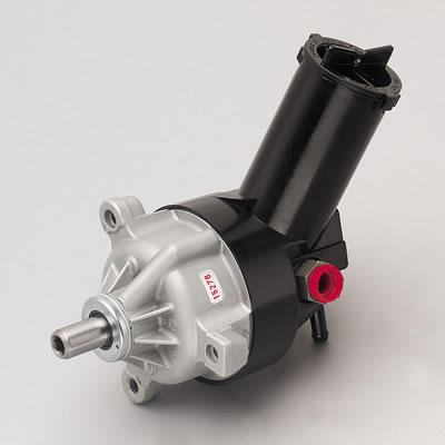

In my quest for a rightuous world governed only by the rules of hydraulics, I've discovered that the steering pump will moan/groan in two situations:
1) When the pump is going to bypass mode -- when the system pressure is beyond specs and the relief valve has opened which recirculates fluid internal of the pump. This could mean that the bypass valve in your vehicle is just worn out or dirty.
2) When the pump is starved of fluid -- dirty/gunky reservoir?
The good news is that replacing the pump on the 1st gen typically means also replacing the reservoir since you have a pump with an integral reservoir on the back (see image below). Whats even better is that the pump+reservoir unit is not very expensive and can be had for typically $50-$70 from most parts store.
