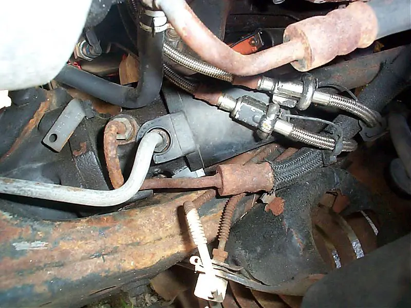

I have ben looking around trying to figure out my very loose steering problem and came across this bushing that is pretty much torn apart. it is not too far from the firewall where the steering column comes out then there are 4 bolts/ or rivets going through this bushing. i have included a picture hoping someone will know what this bushing is called and how to replace it and hopefully where i can find another one. as you can see in the picture it is pretty shredded. thank you in advance for anyone that might be able to help.

That is called a rag joint. A replacement can be bought at almost any auto parts store.
ya its worn :) dorman parts brand are in most auto stores is ur best bet to find one at a low cost
just dont drive that trk another mile till its fixed that rag joint is a serious safety issue
an ur shimmy at speed could be caused by it also acting just like a tire that was outa balance

i will have to check with auto parts store tomorrow. Is it bolts holding it together or rivets? do you know how to remove it and put in a new one? also are there special tools i will need? if it is just bolts and nuts I will have no problem, but it didnt look like it was. and thank you guys for the quick response. I am sure it has been this way for a long time, probably before i bought the truck about 2 years ago. I have been driving interstate miles alot and i guess i am very luck nothing terrible has happened yet. I think i will just drive it the 1 mile to work each day and that will be it til i fix it.

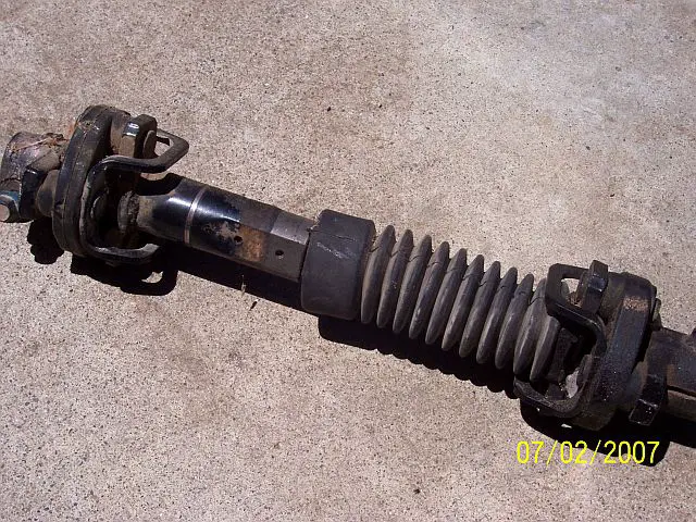

ok i cant tell ya about part # but i think u have two rag joints on ur shalft .
urs is upper but it wouldnt hurt to take the cover off bottom one an look at condition of it
buy ur parts an what u cant use just return for a credit
flame river is a very good brand but pricey if ur not off roading with it just put same oem style from ur local auto store in
tools i thk the nuts are all metric but a basic wrench an a few sockets should be all u need:salute: :salute:
first pic is my upper joint 2nd is lower may not all look the same cause i have a navajo from 1991 an my upper joint is like a drive shaft kind not rag :thumbsup: :thumbsup:

Here's two pics of my spare. I got mine from a picknpull, but you also can get just the black bushing ring at parts stores. I've seen them in the Help products section.
