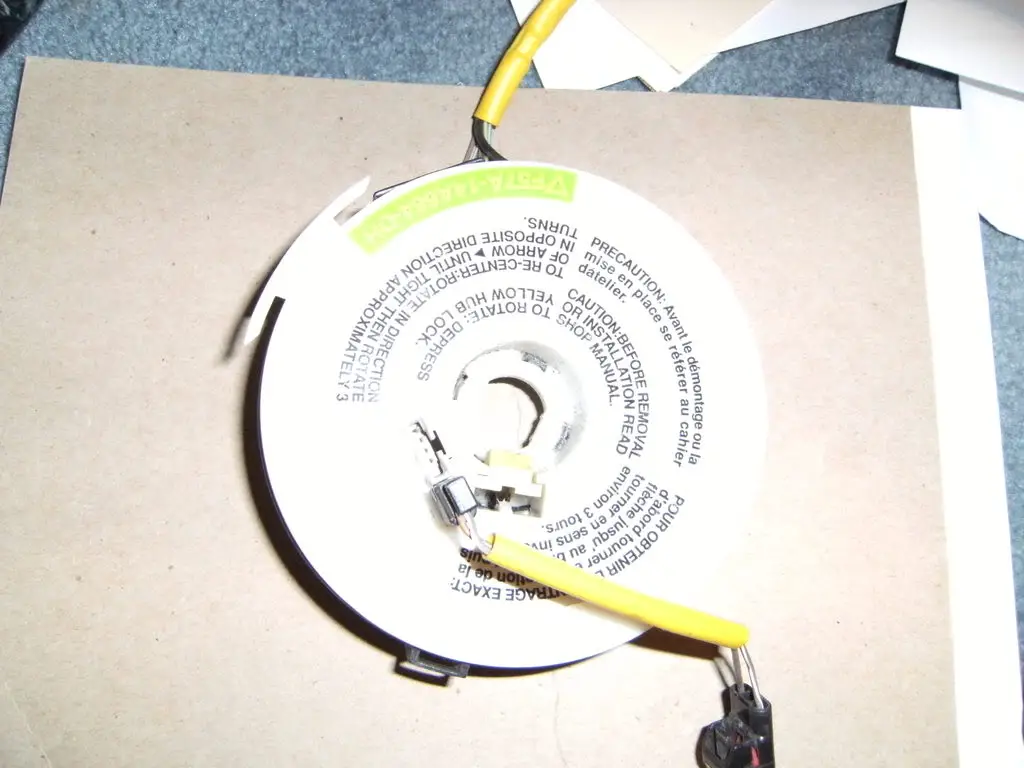

Have a 95, cruise and horn doesn't work. Forum suggest that "clock spring" in steering wheel broken. Went to Ford to buy part and the parts counter guy shows me a circular unit that goes in behind wheel, with wires protruding from it. Is this what I am looking to replace? The part is +$100 so I want to be sure I am picking up the right part.
My Clymers and other manuals don't show a "spring" anywhere but show the part Ford described.
Any clarification would help before I buy the part. I hate to pull the wheel off without having the part available, since this is a daily driver.

yeah that's the part, i had to do it on mine, usually the airbag light is the first indication that something is wrong as it normally flashes.

you do have a clockspring, and it very well could be the clockspring causing your issues, but I would reccomend diagnostics first due to the cost.
Here you go:
You can test it by applying power to one side and then using a test light on the pins on the other side, if the light doesn't turn on then the clockspring is faulty (each wire corresponds to one pin on the opposite side so you need to test them all)
I hope this makes sense

APPLY POWER? but make sure you disconnect the negative terminal?
I get the general idea you are trying to make but I think it sounds a bit dangerous. Don't you mean get a continuity tester and check the pins?
I meant while off the truck, I guess :p: can't remember what I was thinking 3 years ago lol
Just to avoid confussin, I went to a auto body shop that as parting an explorer, removed the clock spring, tested it as described above and then once every pin lit up, bought it and replaced my broken one with it
