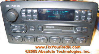

Does your stereo have the CD controller features on the radio station buttons like on the stereo pictured below?
Black Widow- I have a 2000 Sport. It came with factory single CD but it has the ability to control a Factory CD changer. If you have the factory changer - you just need a single factory single CD player form a ranger, explorer or even an F-series between 98-2001.It needs to have the world connectors on back ( two multipin connectors that are side by side forming a L shape in lower corner of back of unit)1 is a long rectangle shaped connector which is audio & power connections. The square connector right beside it- this is the one used to control CD changer as well as for back seat passenger headphone tone & volume control.I recently replaced my single cd with a factory indash 6 pack changer from a ranger ( or F-series) circa 2003. It was plug & play.Maybe that would be an inexpensive option for you. Ebay search Ford Cd Radio- look for the "world connector" on back which is the two square & rectangle connections I described above. It does work. I am happy with it- maybe you would be too.
