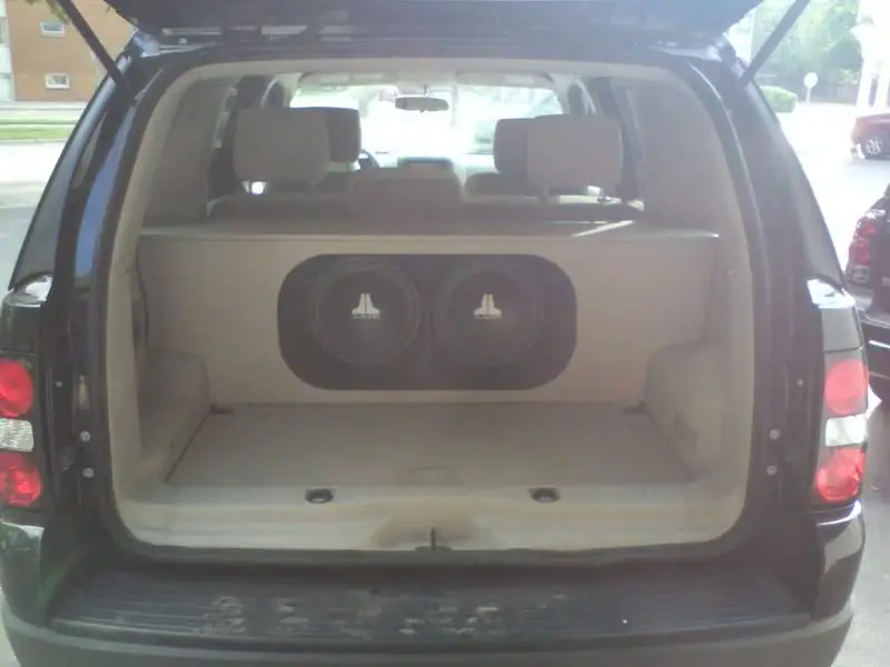

let me know what you guys think. I think it turned out very good.
That looks pretty sweet, whats the specs on that stuff?
That's a real nice setup. Good match to the interior, and it looks like a factory install.
Could you list the components/specs on your system?
head unit apline w200
front speakers diamond audio d6 series 6 1/2 inch components
amp crossfire 804 front channel to front components, rear channel to subs.
subs jl12w3 in a 2.5 cubic foot box, sealed
That does look nice.... did you fab it yourself or have it done? and if so by whom?
did it myself. took a few days just working on it here and there in some spare time
Thats awesome, do you have box specs? I really like the look of that. Very clean.
