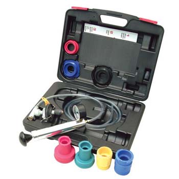

Pressure testing is an option. I'm not sure if autozone loans out a kit, or if you'd have to take it to a shop to have them do it, but it could show you for sure where exactly the leak is. Of course, if the shop wants 50 bucks just to pressure test it, I'd suggest just putting that towards a new radiator instead...
I would start at the radiator. But, they are not always at fault. Check the cap too. Fill the system and pressure test. If it does not leak chances are the cap is to blame.
