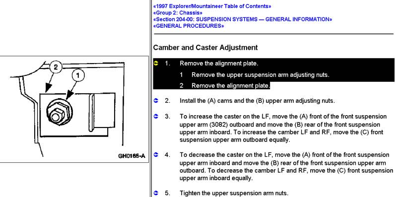

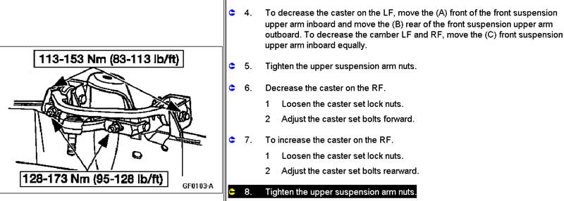

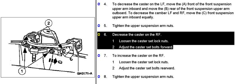

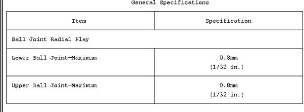

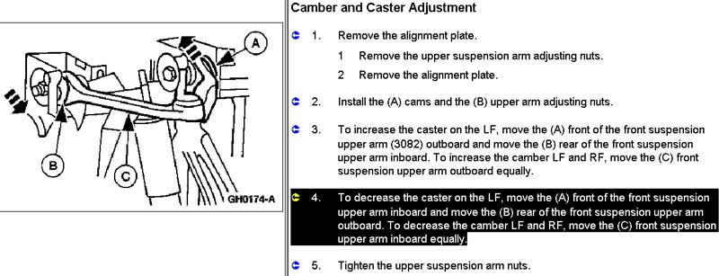

Of course you need some way to measure, but here you go:
