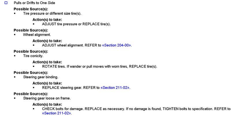

Its actually a rack and pinion type. I looked for a spec on allowable play in the steering gear and didn't find anything. I did find this symptom chart:
it is rack and pinion? hmm.. ok. Everywhere I looked said "steering gear" so I assumed it wasn't rack and pinion.
and that chart points to a bad steering gear.. bah.

From the chart above, I would check if the rack (steering gear) was bolted on tight and hope that it wasn't. Otherwise you are probably looking at replacing it.
that's my plan for Saturday. I already attempted to check it yesterday, but was only able to get a wrench on the top nut, and yeah I couldn't tighten it, but no clue what the torque specs are on it currently.

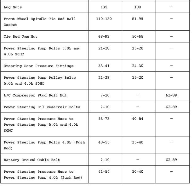

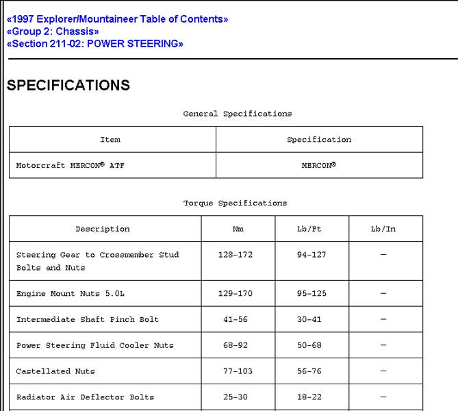

I have the torque specs for it
that's not what I meant.. I got that info. But thanks though :D
I meant I have no clue how tight the nuts/bolts are tightened down. It's atleast enough I can't tighten the nut with a stubby wrench. :p
well I got a little tug out of the bolts, but they certainly weren't loose. They're at over 150ft/lbs

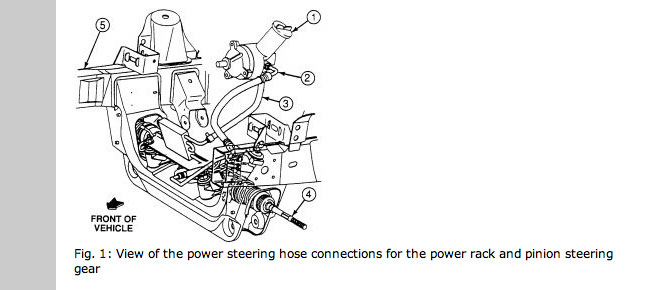

1st Gen Explorers use a Recirculating Ball type of Steering Gear which has a Pitman Arm that moves the steering linkage.
2nd Gen Explorers use a Rack and Pinion type of Steering Gear that attaches directly to the tie rod ends.
