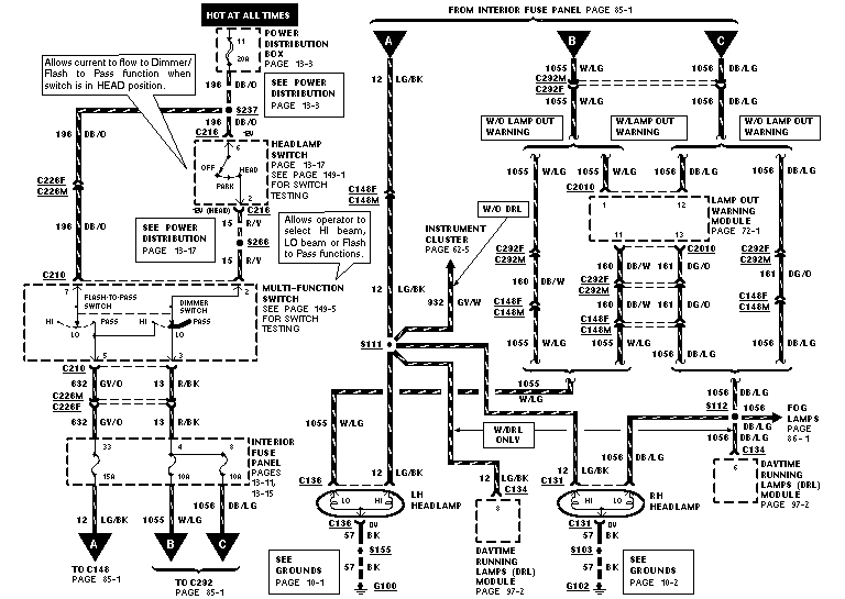

my 96 explorer has the automatic headlights and they wont switch on. the problem apears to be somewhere in the linkage between the module that senses the dark and the realy that turns on the lights. the problem also extends to the remote locks, when you press twice the lights normally blink... now they dont... I imagine they use the same realy system.
does anyone have a scematic or details on where the modules are located I eed to be looking at, or any repair ideas?
And here is one of the headlamps
good luck :thumbsup:
Nate
If you are having trouble reading these I can post the keys for them.
Nate
