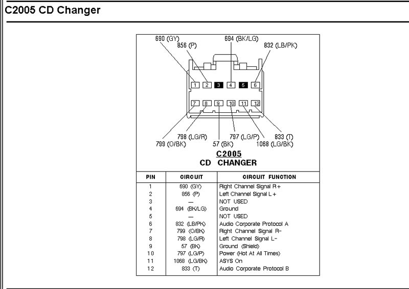

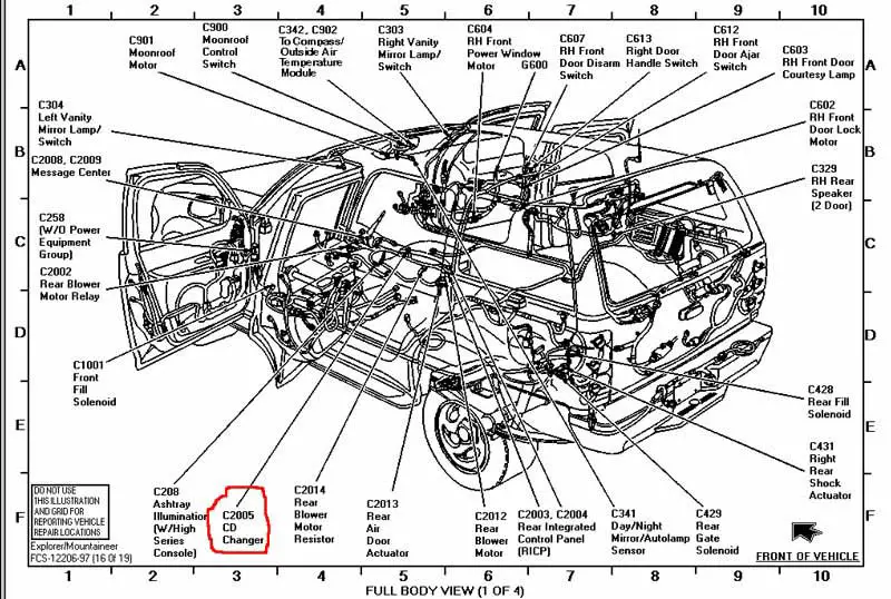

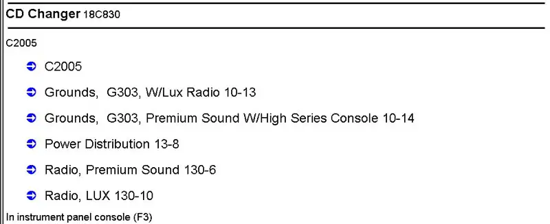

The harness connector is in the instrument panel console (aka the center console). The connector is C2005 which is a 12 pin connector.

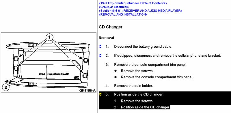

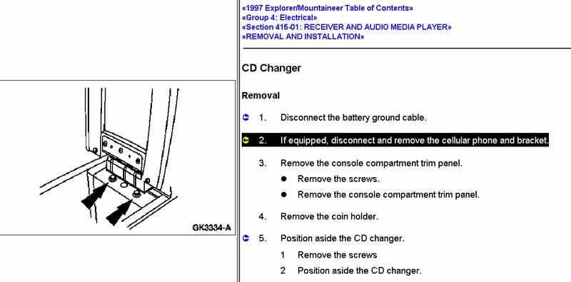

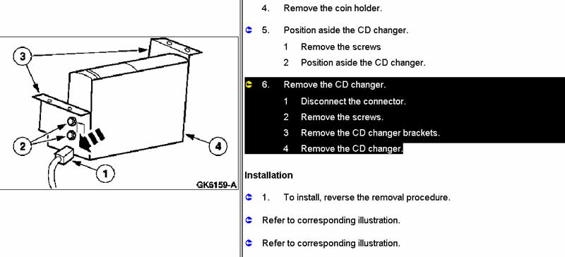

Okay, first I checked to see where the CD changer is mounted. The illustrations kinda suck, but I'm positive that it is mounted inside the center console.

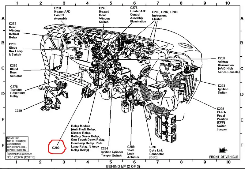

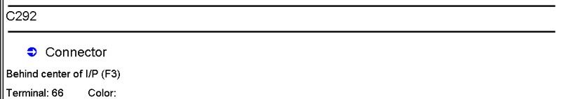

So why isn't the connector there? My speculation is that they only supply that part of the harness if the changer is installed at the factory. But on the schematics, I can look for the wiring and find out where the next closest connector (the one the missing harness plugs into).

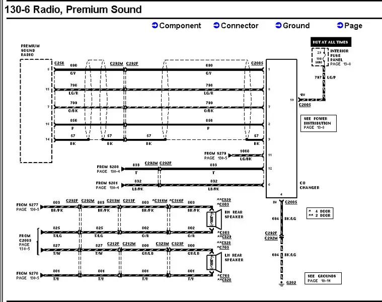

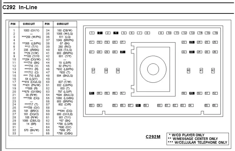

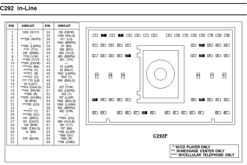

From the schematic, it looks like all of the wiring for the CD changer passes thru connector C292, so I would look for it next.
P.S. I think it might be that huge connector in the middle of the pic where you show the relay on the left. Check to see if the wire colors match.

I forgot to post the schematic:
That big plug is actually connected to the rear controls. It must be the one in the diagram, but the wires that I have that correspond on there are a little different, colour wise.
The only open plug is that one in the first picture. I don't see it labelled on the diagrams through.

In the C2005 diagram what the hell is "Audio Corporate Protocol A and B" and ASYS.
I'm trying to find a +12v that is hooked to the lights so I can install cup holder LEDs.
My guess is that Audio Corporate Protocol A and B are serial bus signals to communicate between the CD changer and the Main unit.
Also guessing that ASYS On means Audio System On. This might be +12V when the Main unit is on. There is also a Power wire in that connector that is on at all times.
