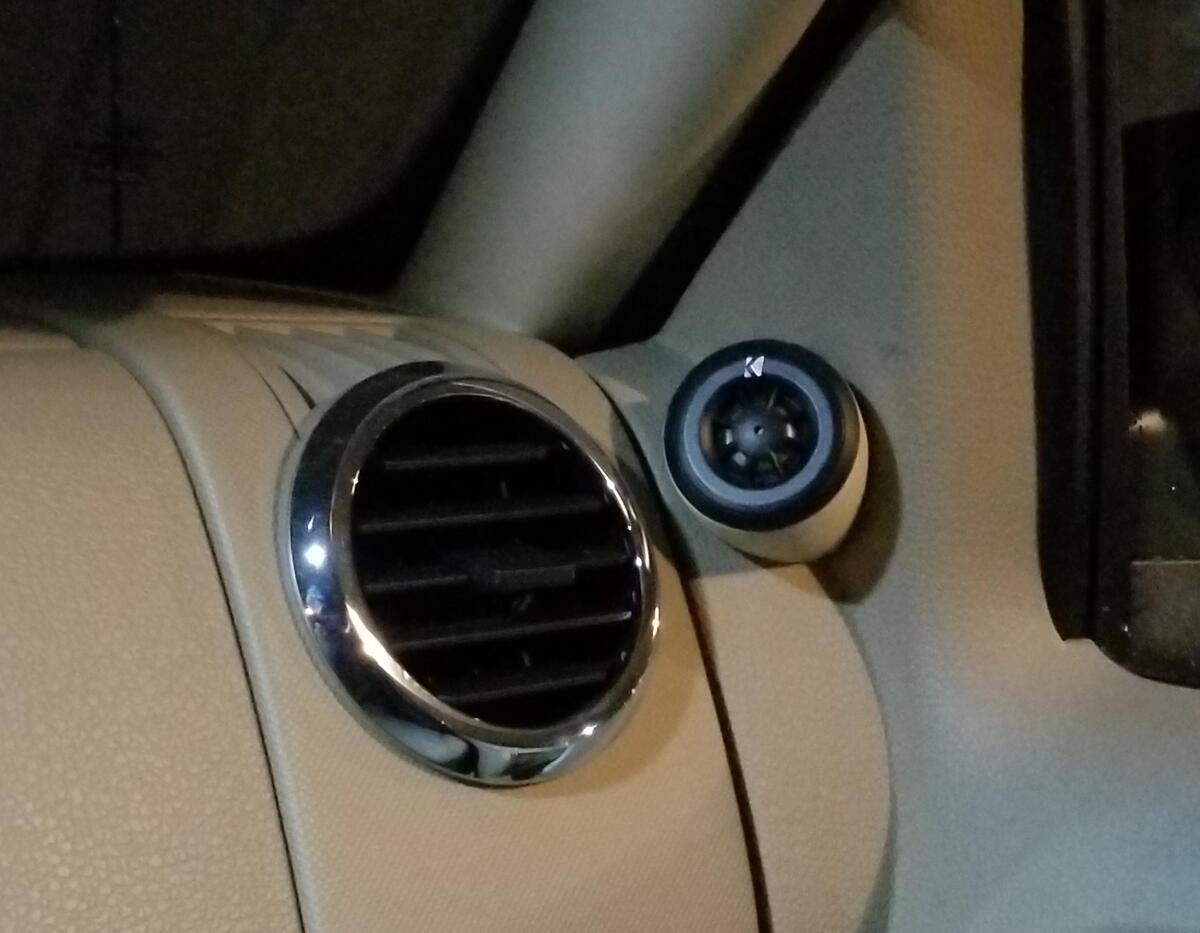

Here are the mounts I made to add component speakers to my system. It may not be the easiest way or look the nicest but it works for me and the sound is much better. I used Kicker 43CSS68 speakers.
I made the mounts out of balsa wood and epoxy putty. The epoxy putty was used to mold the rough shaped balsa to the door panel then sanded it round and painted to match the light trim in the car.
This look pretty good, the Focals came with a similar looking mount for the tweeters, but I had wanted them to fit flush with the panel.
If they did not fit though, I likely would have almost the exact same set up that you do.
