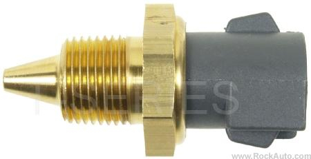

Runs poor when cold. = ECT
Runs good cold but not hot, also = ECT
It's the pointy one behind the t-stat housing. The one in the housing is for the gauge..

I change the clutch flywheel and slave last month so i don't think there's an issue there. also i have replaced the air filter and cleaned the maf so ill clean the iac, put a new fuel filter and ect sensor and take it from there.
