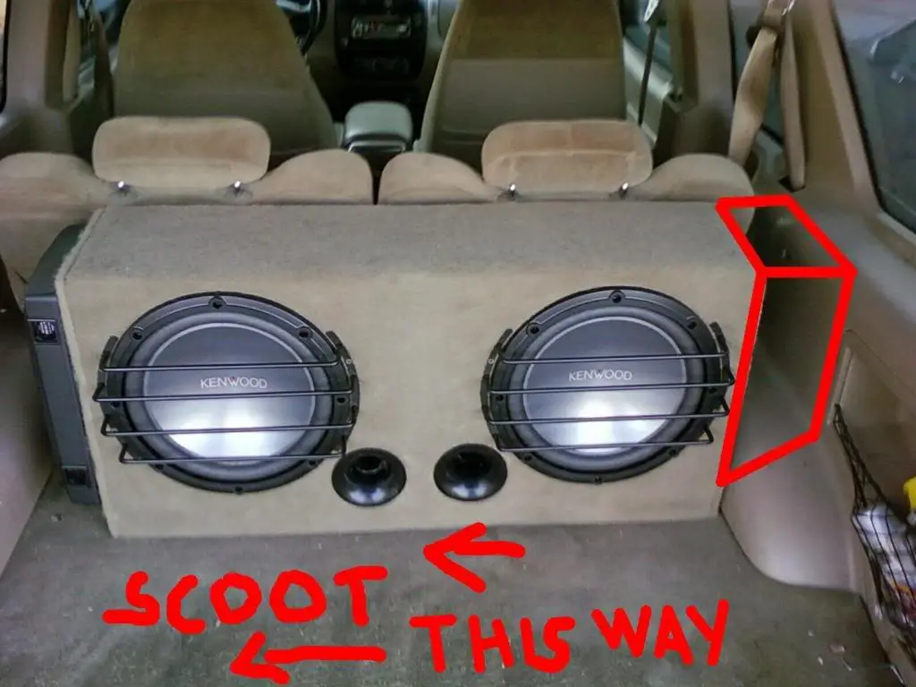

And finally my vibration question: If i, scoot the sub box over for more room on the side, and mount the laptop inside a (fan cooled) enclosure, concept is the red box on the right. Am i going to end up vibrating my carputer to death with the subs? Or should i just mount it somewhere else?

I could be wrong, because its not as if i could walk to the garage and look. Either way, do you think the components would be safe if i lined the computer enclosure with dynamat? if necessary i could mount the HD itself on brackets with foam inbetween the brackets and the wood as a shock absorber. would dynamat maybe cause heat issues?
what about if i screwed everything to a board and mounted it all on the back of the back seat behind the box? (this would be again right next to the subs but mounted on the seats instead of the box itself, i would think that would reduce alot of vibration, however air flow might not be as simple to acheive.

And either Mounted on back of back seat (between sub box and seats) or the original concept, red box in the picture. In using either of these locations the components would have to be protected (dynamat?)
Has anyone had experience with a dynamat-protected carputer enclosure? I know the foam is designed to absorb vibrations (for that price it better anyway) and the one with the "aluminum-y" layer would help with magnetism (i think). Is this still too risky of a mount?

what about mounted on the back of the back seats, protected by dynamat.
also a layer of dynamat on the inner rear of the box inside the box behind the sub
I know i have a lot of blind faith in this dynamat, i have never used it or even seen a good application of it before.
Would this set up work? theoretically any vibrations and/or magnetism would be negated by the total 1 layer of dynamat(inside the box), 3/4" MDF (rear panel of sub box), and another layer of dynamat.(on the carpc hardware itself)
