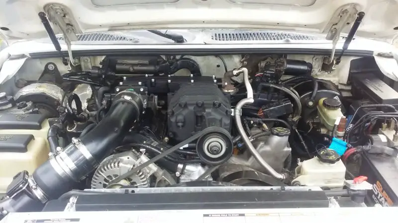

Finished

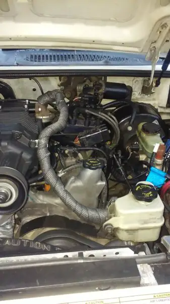

Today we put some exhaust wrap on the egr extension tube

So my son wanted to put the supercharger decal on I wanted the stock look so this is the compromise and I wrapped the intake tube with the leftover exhaust wrap I know the decal is a little off but it's cool

Awesome for a lawnmower engine!!!! Seriously though, looks clean, sanitary even! Congrats!
I added to an older cast/welded kit with couple items from ModdBox, I had CNC envy for that nicely cut kit! Good stuff!

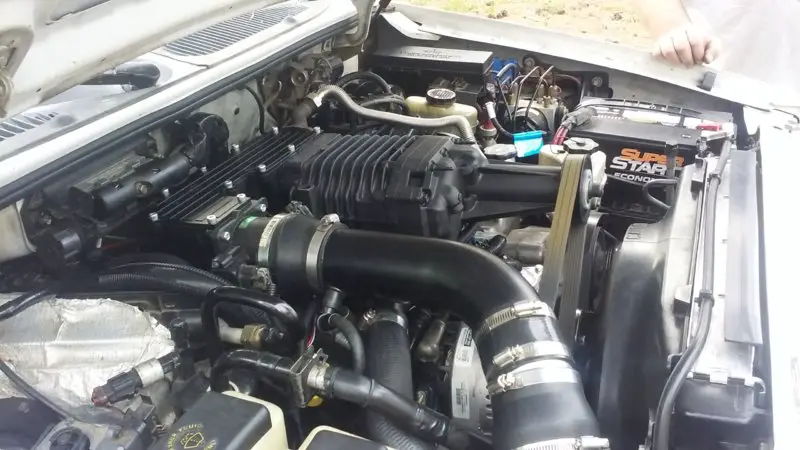

I also insulated the intake tubing, stock air intake box and modified the stock box to pull cool air from the fender.

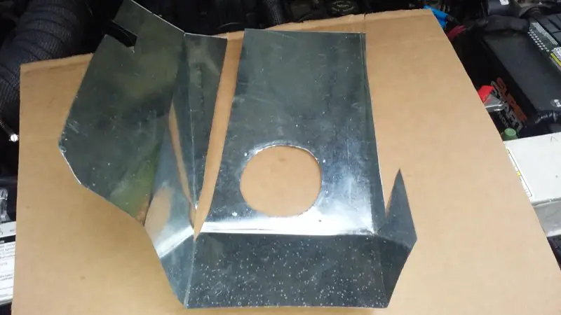

So i wanted to make a heat shield for the air filter on the new supercharger explorer so that the air would only come from behind the headlight.
My dad said that every degree counts!
So we went to Lows and got an 18" by 36" sheet of metal, foam pipe insulator, and pipe insulator tape (as shown in the pics below :thumbsup:)
We found this information that we used from an old thread on here, but we made ours to our thoughts and liking so it is very different.

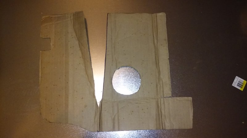

We spent a good hour making a cardboard template for the metal sheet.
Then we cut it out.
And also bent it the way the template told us to, using a straight edged block of wood (and a small hammer if needed)
