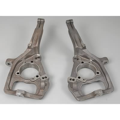

Last time i had talked with them the front kit for the sport trac was due to the bigger brakes. but the kit i bought from a friend was a new updated kitthat had multiple mounting holes for the caliper brackets. so wen I called they told me they kept the site like that so no one got confused for you id just get the complete kit K494. if it helps i will take pics tomorrow at work.

I couldn't get a picture of mine covered in mud and all but here's what I'm talking about all the kits made from 07 and up I was told are like this.

I think that kit is actually only shocks and related hardware. I don't believe you get the knuckles.

Ok i just read the site it looks like if you want just the front you need both the #9633 and the #9637
#9633 front box kit come with everything but knuckles

then you'd need #9637 Front Kit Box, 4" Lift 2001-Up Ford Explorer Sport-Trac
it contains
Part # Description
66-01-9636 Knuckle, DR (RED NO ABS TUBE)
66-02-9636 Knuckle, PA (YELLOW, NO ABS TUBE)
77-9630 Hardware Bag - 9630 Kit
If you want to get technical you could look at the downloadable installation sheets and look at the parts list and match the part numbers with what i just posted.
