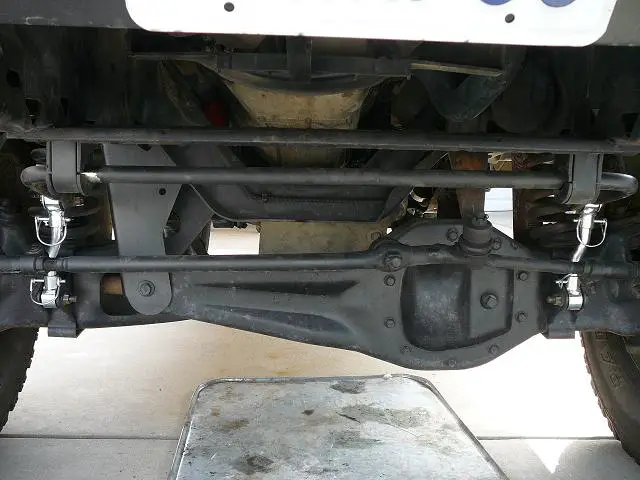

I had the sway bar drop brackets and one cracked over time. I found these sway bar quick disconnects from warrior products and they allowed me to remove the drop brackets.

Yup they work fine and the bar sits as it did when stock.
Pin at the top pin at the bottom pull them out and the center bar comes out The ends stay bolted on. If the picture does not appear scroll up and look at the picture of them installed on my X.

I like them. I was going to remove them completely, but I have three kids that think its cool to ride in the X so I wanted another solution. So far so good.
