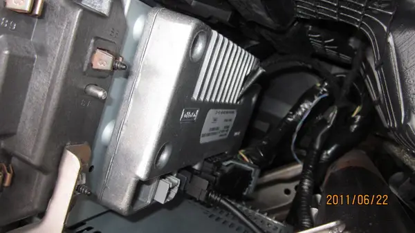

I am thinking it is an antenna problem in the truck or the antenna is unplugged. Where is the SYNC module or antenna located? Can I swap out the radio with my 2013 PIU to solve the problem? Inquiring minds want to know. Thanks.
There is no separate BT antenna. That is all built into the APIM. Have you made sure your SYNC software is up to date? If not, update it and try again.
I did try the 15 min battery disconnect to reset it and that failed. Can I use forsca n to update? Where is the accessory protocol interface module located?
No, you get the update software from the Ford Owner site. You need to sign up and enter your VIN and check for SYNC software updates. Updates are done via USB.
........... Where is the accessory protocol interface module located?
In the retail model it is behind and attached to the radio.
