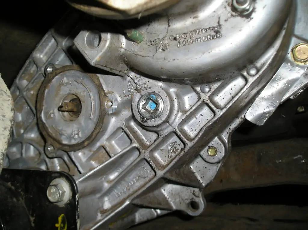

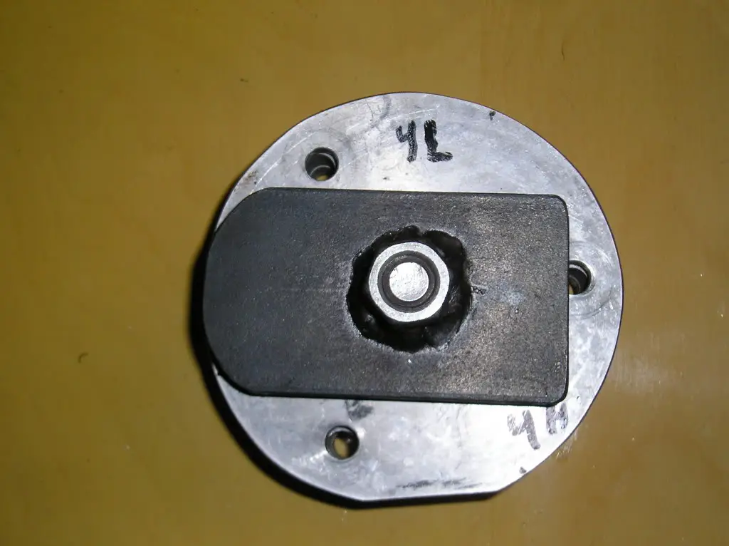

What I did is Remove the motor and use the gear and gear casing to make a shifter.
Those pictures may help to figure how I did.
would it be possible (looks like it from the pics) to permanently make it a manual shift? im assuming you would need to make shift gates so you dont slip out of gear, correct?
My last version have a hole in the rotor handle and 3 hols in the top plate to be sure nothing slip. I used a pine to lock every thing.
Bun If you put more pressure on the 3 holding screws, it wont slip. My truck is working like this fore more than 2 years and I don't have any slip problems.
Can you post a better explanation of what you did?
I get the bolt welded to the stock gear and how the housing was cut, but don't understand the locks to keep it from slipping out of gear.

What I did vas to drill 3 hols in the plate ''were you can see 4l, 4H on it'' and one in tra rotor handle.
The hols were exactly aligned were the gear was supose to stop when angaged in different gears (2H, 4H, 4L)
I yoused a kind of cutter pin tu block the rotor handle
That pin pass in the rotor handle hole and in the top plate hols.
I will try to bring som pictures
