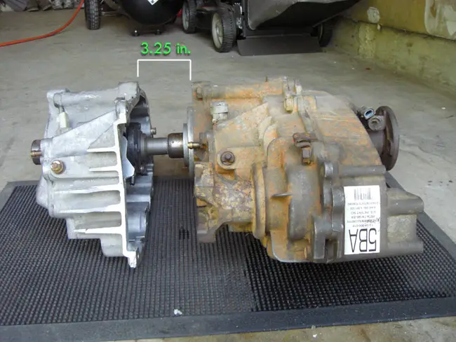

But just to make sure, transfer cases typically come with a sticker on the side. In the image below, ignore the stubby silver thing on the left, but you can see the sticker on the transfer case on the right (reads 5BA)
If you can find a transfer case with the exact same letters, that is an exact match.
we def did not see a label when we pulled mine out. Im gonna have to clean it up a lil and try to get some stamped numbered off it to match up at the yard. Do I have to worry about different spline counts if the tranmission is different?
