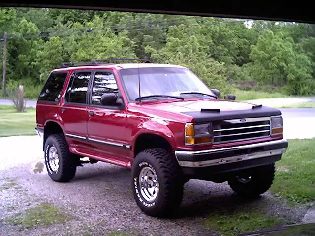

It is excellent. Check out my truck pics when it was stock, then looks at the ones lifted. The june 0126 is just aftwr the caly bar I think. It is definately worth it.
This picture? Nice shine. Did you use the "perfect shine" when you did this? Is this also using the clay bar? I can't wait to get started on my red X.
Yes, thats the pic. I used Mothers clay bar kit from autozone and then waxed it with Maguires.
