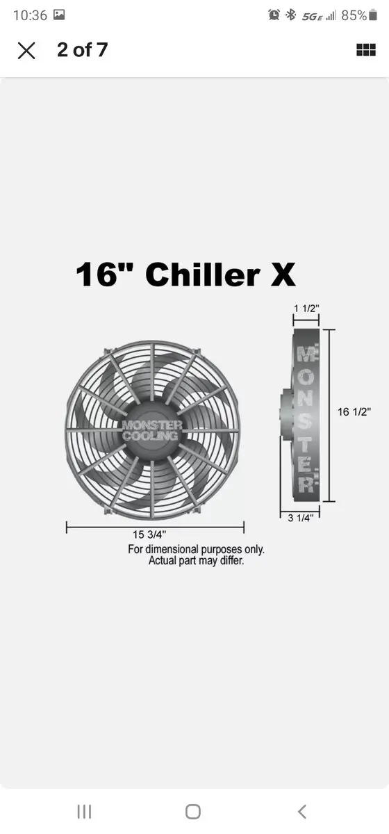

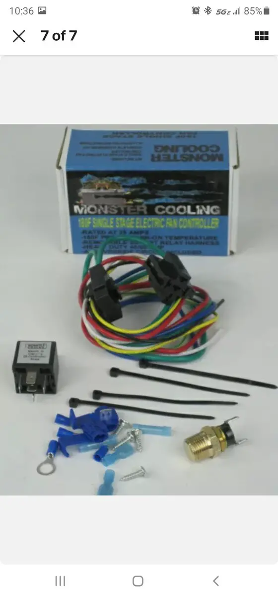

cause as it sits the monster cooling kit came with a 16 inch fan , a relay a themeral switch ( which replaces the stock sending unit has 12volts from ignition going in then when it reaches 180 degrees then is sends that 12 volts to the relay to kick on ) and the wiring harness and mis equipment for intalling fan and wiring . i was just going to use the oem gauge, i tested with a temp gun and it drops the temps 15 - 20 degrees in no time . i will post pics here shortly to show what im working with .

That resembles the kit I put on my 5.0 ranger. Has worked fine for years and years.
