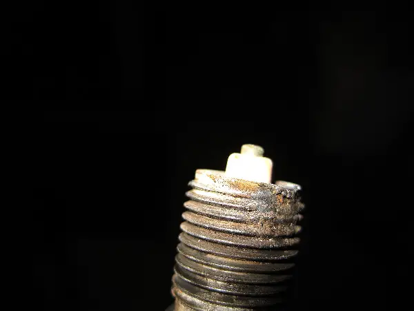

I went to change out the spark plugs yesterday and the left side cylinder bank came out no problem and they all looked to be in excellent condition with no fouling or oil build up. The right side however were in bad shape, covered with oil and fouling marks.
The right front spark plug closest to the timing chain tensioner was loose in its hole and when I pulled it out the top electrode was sheared clean off and the threads were stripped on one side. Dark black fouling all over the ceramic and some oil. Well I was puzzled but still replaced the plug, I new it was not going to be good when the plug would not tighten down but just kept spinning.
When I went to start the truck I heard serious knocking coming from that Piston and then a lower end rap and compression was way down. Truck could not hold idle either. I did not drive it on the street just moved it around my driveway a bit.

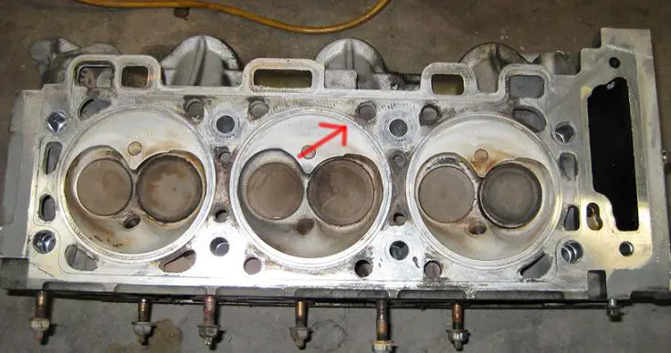

My first thought is that the right bank timing chain slipped enough for the piston to collide with one of the valves enough to bend over to strike the spark plug. The spark plugs are angled toward the exhaust valves as shown in the photo below by shelbygt.
However, if that happened I supsect there would be zero compression for that cylinder. Are you sure there aren't just spark plug fragments laying on top of the piston?

I went out again tonight and started it up, not a bad rattle it does sound like some spark plug fragments are rattling around in the cylinder. The other problem is that the spark plug threads on the engine block for that cylinder are stripped out by the Piston valve collision- so the plug is in there only loosely it would not get tight. I am definately loosing compression in that piston.

The engine is so strong and in such good shape, as is the interior. I have decided to take it to my mechanic and let him have a go over it, as the knocking is intermittent & not that bad. It could be just a bent valve or the piece of the spark plug that broke off. Though loosing compression in that cylinder through the spark plug hole is not helping matters.
I have attached a pick for reference, plugs are lined up exactly how they came out of the engine if you're facing the engine bay with the drivers side on your right.

I was able to drive the truck around today for about 10mi with no real issues just a little tick in the cylinder with the bent valve. The Spark plug is very loose in the engine block on this cylinder and causing a lot of blow by.
It seems that the timing in Cylinder 4 I believe, was off and the piston collided with the valve which bent and smashed into the spark plug end. As seen in the photo it sheared off the side electrode and must have striped some of the threads on the spark plug block.
When I put the new E3 Spark plug in it did not have enough clearance, as an E3 plug has a huge Diamond fire Electrode and I believe it was this that caused the extra noise and chatter- until the valve bent enough to get around it.

How many miles did you have on the bad spark plug in #4 cylinder? From the photo it almost looks like it failed from corrosion or detonation.
