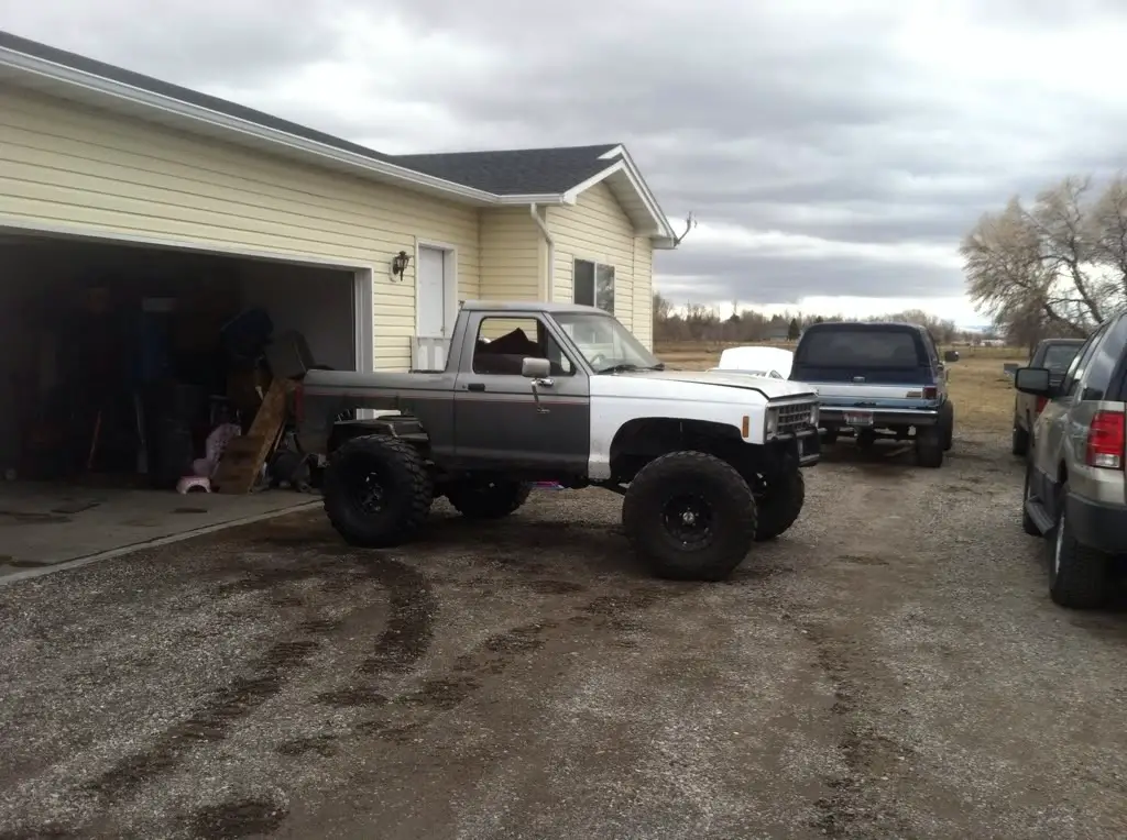

ok got the doubler in and test drove it, its slow but not quite slow enough for me, looks like the diffs need 5.13 gears. here is a pic of it outside finally,
unfortunately the drain plug is leaking pretty bad and the doubler case wont shift out of low. so out they come once again, ill pull the front of the doubler case off and see what I screwed up in the assembly. im guessing I probably put the case together with it in low again, happily it doesn't have a back half to break out, it just pushes the doubler shaft further into engagement with the back case. so I didn't totally hose myself.

You probably tried this but did you shut it off, put tranny in nutral and try shifting out of low with no load whats so ever on the shifting forks?
Sounds to me that there was some thrust on the gears.
BTW truck really looks great.
