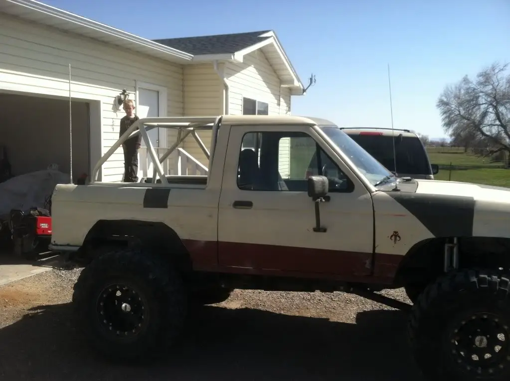

decided to paint the cage, looks pretty good I think
I ran out of paint so a few tubes aren't quite done, I think it looks good on the tube

I like it too, but with exo added. I guess tube doors would be too much to ask for?

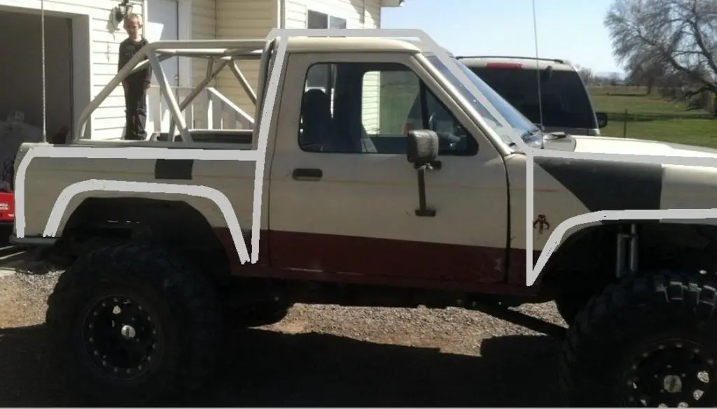

trying to keep it really understated and simple, the halo on the front is going to go inside the roof and come out the front, then the A pillar is going to go down to the fender, and dive inside the fender down to the slider, I have thought about doing some tube fenders, but once I go full crawler and narrow the front I'd hate to chop out a bunch of tube work. And if I do the rear tube fenders it will look weird without front ones. I thought this would be a hybrid exo/interior cage but it is really going to be a lot more interior then exo
