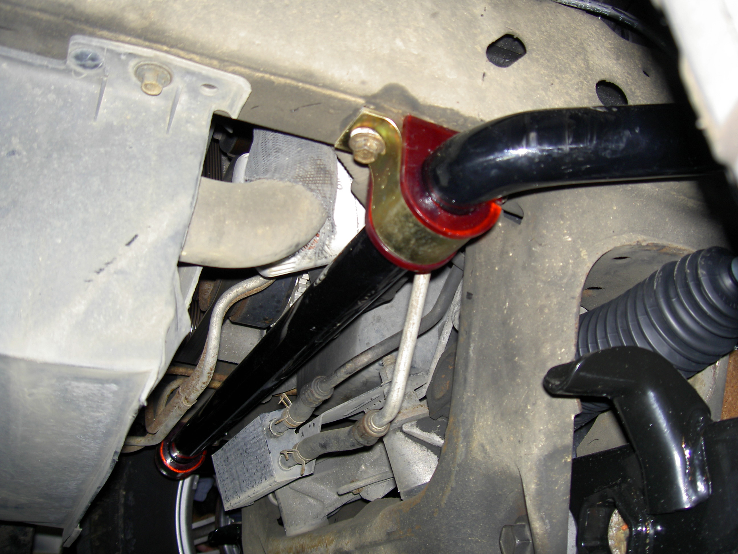

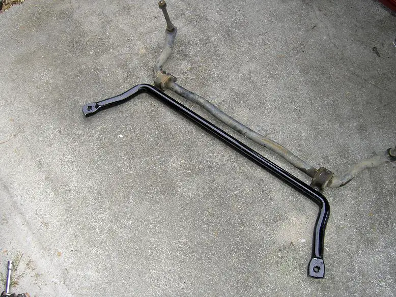

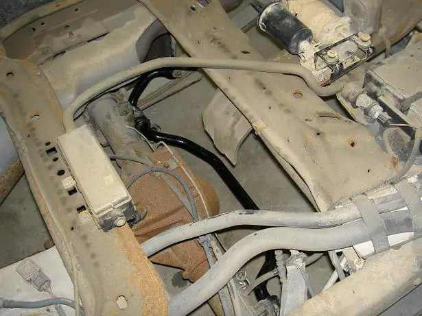

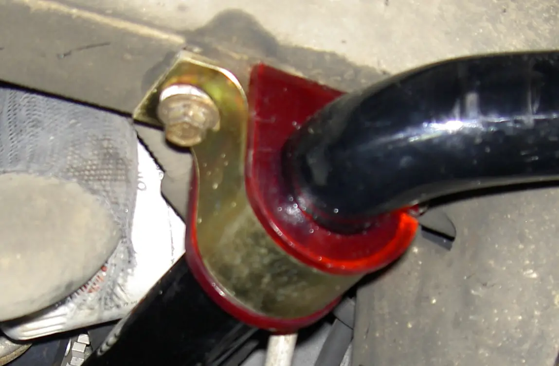

rear end links, someone posted up that you can use ones from i believe from a f250 (or f150) for the rear if you are lowered 2 inches. for the bushings, i have moogs. energy suspension rear sway bar bushings (1 1/8), and a EE rear sway bar. for leafs i have a pair of 4 door leafs with a add a leaf in them (from dono's old v6 supercharged truck) i went threw i think 3 different sets of leafs until these not only felt right, but also didnt bottom out and have 2 inch lowering blocks. the front i cut the sway bar endlinks, and found bolts that are also 2 inches shorter. have gone threw 2 different bars because the first one ate bushings like they were free. monroe shocks also up front. why monroe? life time warranty. when i drive my truck, then drive my sons 01 sport,the handling is extremely noticeable. his truck i feel like i need both hands and my teeth on the wheel to steer. mine, i can do a cloverleaf at almost 60 mph.
