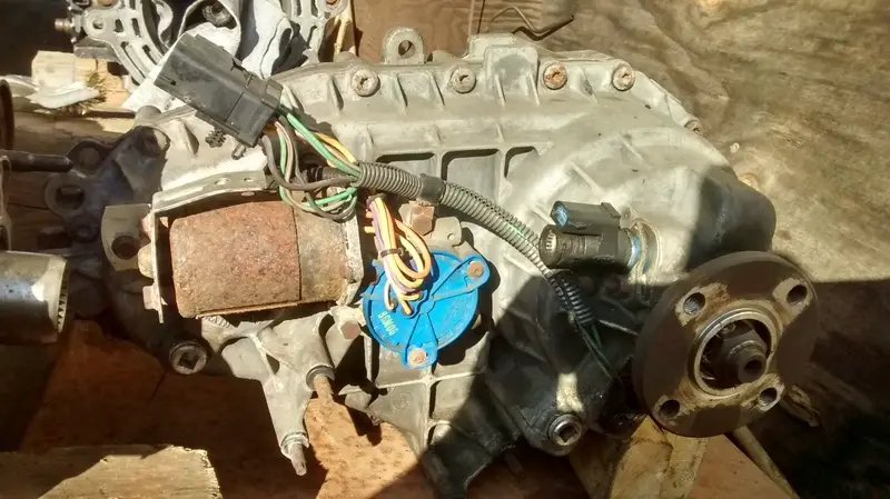

Ok, So thought I got the same thing as was in my truck, but upon close inspection today when went to swap my 2 speed sensors over to my replacement trans (original ones were broken), I noticed the one was in a different location, with a different sensor (or so it seems). The original sensors connection faced straight up on a 45 deg angle, and the sensor from my truck faces straight back to the rear on a 90 deg bend. I dont have a pic of the orig sensor from the donor trans as I threw it away days ago, before I realized I had this problem. Also I didn't get to look at the bellhousing or take pics of it today as my shop was closing, I was rushing and forgot. But her are the pics I do have. The sensors I'm asking about have been circled with whiteout for ease of viewing...
Question(s) is; Can I use this replacement trans or not? If so, what's need to do so? Why the different location? Do they both do the same thing, just a different year and placement or something? (Both trans have only those 2 speed sensors)
First up is the trans that failed and is being replaced(Sensor bore right after bellhousing). Also included is the transfer case, (which I was hoping to change, but obviously can't do now) so that may help to identify what trans I have and what is was originally in.
Now the transmission & transfer case which I WAS planing on installing tomorrow (Sensor bore above range selector)

What did the donor trans come out of exactly?
Doesn't the Ford part number 1L54-----CC indicate it was from a 2001 Ranger?
I'm not sure. Thats what I'm asking. I'm also asking if I can use it or not. Of all the info and pics I searched through I have not seen a case with the sensor bores in the locations they are on mine.
Here is my 98 5R55E... differs of yours too
Ok so maybe I can use i. If I do the recall where just crimp the 2 wires for the ft ODD sensor. Plug the middle one. And use only the rear most one, and my VSS sensor on my t case. Then it should work as my PCM was never using that middle sensor. The ISS I believe. Am I rght in that line of thought?
That combo looks like it came out of a Ranger. The 1354 t-case is the main give away. That year ex had the 4405 as shown in the first pics. So right off the bat you wont be able to use that 1354 in your truck. They work differently and are controlled differently by the GEM. Your GEM wont work that case correctly.
