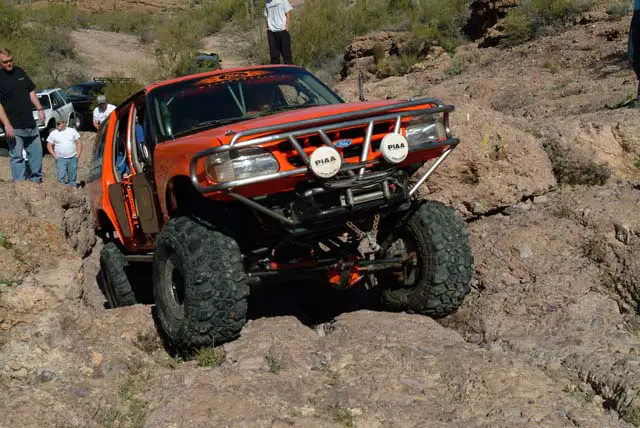

Does not sound like fun. Rick I heard you were not running the fiberglass front end anymore? What do you plan to build?
I bought a set of steel fenders and painted them to match. They give me more clearance between the body and the boulders and I can see around them better than with the flared fenders.
Cool. I see your point. That's quite a bumper!:eek: Looks mean.
