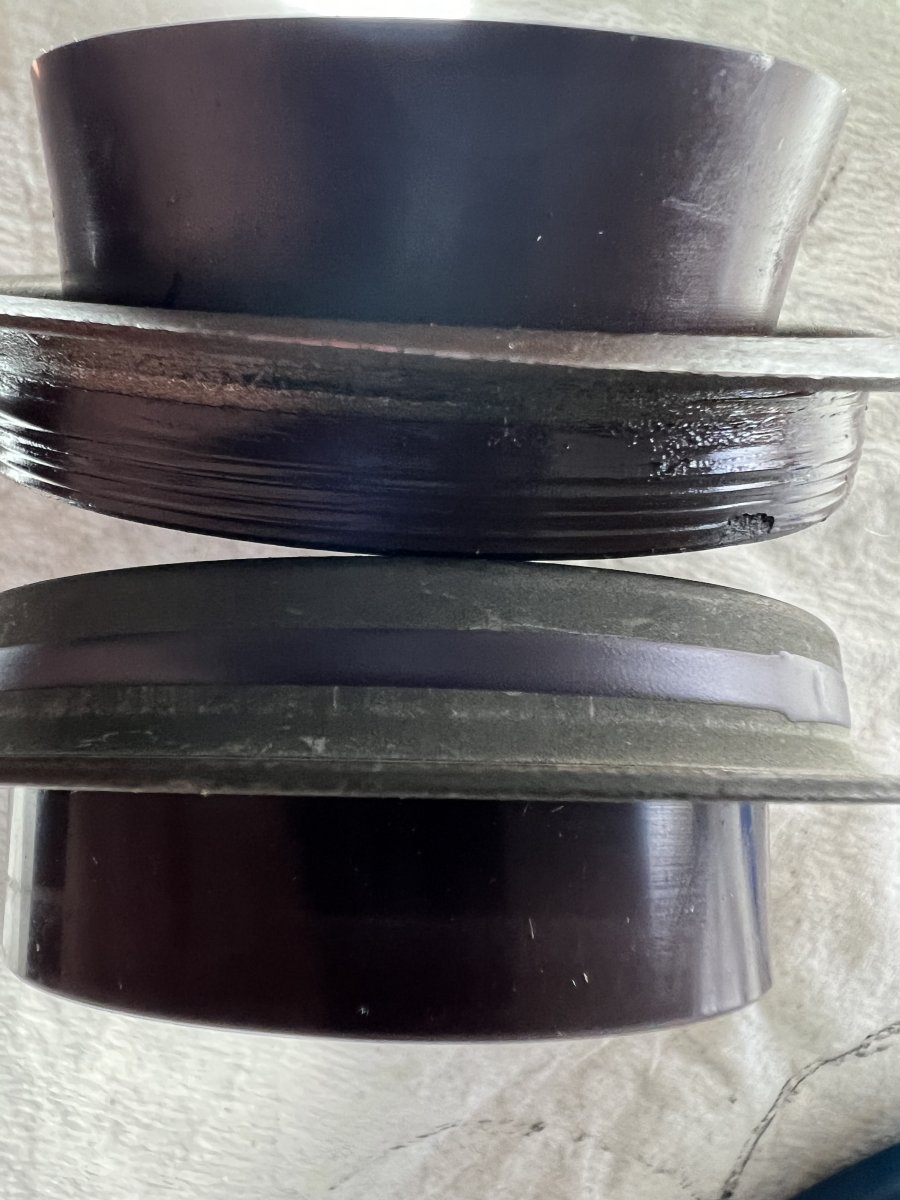

Having a heck of a time trying to get the passenger side front axle seal installed on my 99 mountaineer AWD. Drivers side went in smooth. Using Timken 710428 on the passenger and 710429 drivers side. Gave up after lots of banging and finally warping the seal. Was told to try a National 710428 due to a different design. Anyone else deal with this?

Closer inspection of the Timken was a little disappointing after purchasing the national seal 710428 (both use same part number). National uses a thicker gauge metal on the outer ring as well as a different sealing design as seen in photo. Timken on top
Just an update. The National 710428 went in without a hitch. Not sure what happened with Timken on the passenger side. Used seal drivers and everything in between with no luck. The outer metal ring on the Timken is almost 1/2 the thickness which is prone to warping during the install if your slightly off.
