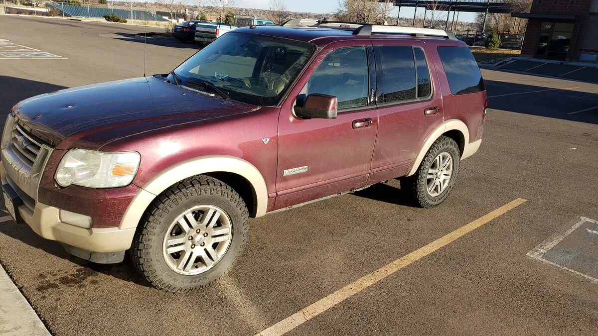

So I just picked up a 2008 Eddie Bauer v8 package 4th gen it has 18in stock rims on it runnin 235 65 r18. Now I don’t want to go crazy but I want to but some bigger tires and possibly do a lift or leveling kit but not sure where to start any advise would be appreciated.

I've got 245/70/17 on mine, stock offset Motegi wheels, no rub.
Having gone the leveling kit/larger tires route on my Expedition, not sure I want to run a bigger tire than what I have on the Exploder now. But I would like a little bit more height...it looks like a car compared to my Expy.
I can tell you having just done this a week ago the maximum you can fit with only minor rubbing are 265/65-18 with stock wheels. Only the passenger front tire rubs slightly. I'd do a little trimming but I am doing the Truxx leveling kit whenever it gets here. Previously I had 255/65-18s on it(odd size apparently) and they fit perfectly no rubbing whatsoever.

Looks sweet so those are the stock Ford rims too

What kit do you have on there?
