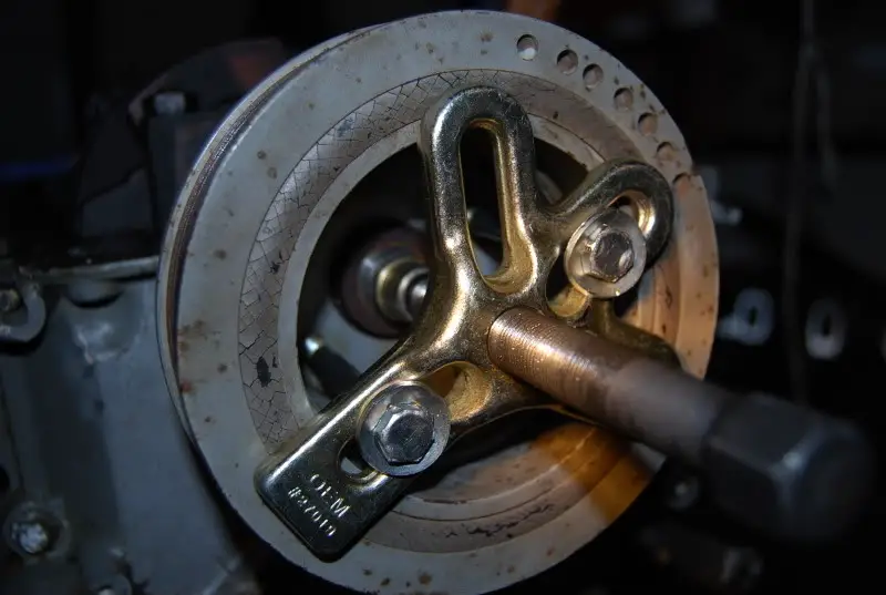

Now, I need to figure out what sized bolts go in to the crankshaft pully to use the puller. The thinks the haynes manual doesnt tell you.
jd, so youre telling him not to reuse the crank bolt, but you were fine with me reusing mine until it got stripped and had to buy a new one anyway.... turd
as far as putting it back on, if it looks like this, and you have that crank pulley:
use the ac compressor bolts to thread on the sides, and use a bolt from the kit to take it off.
disregard the washers in that pic, i was trying to make the kit bolts work. i didnt use washers for the ac bolts
Thanks! I came to exactly the same conclusion.
