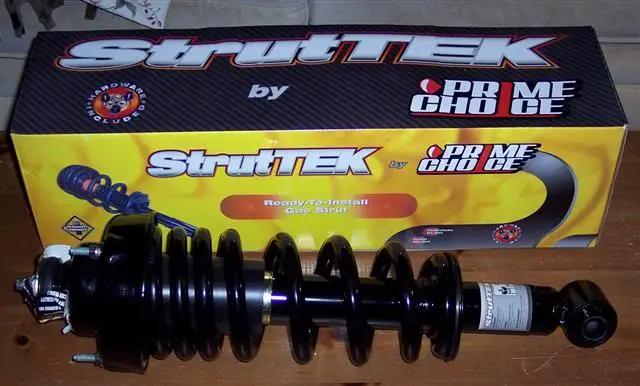

I have the Struttek's installed on the rear and will be putting them on the front very soon!! I am very happy with them. :D
http://www.primechoiceautoparts.com/
http://www.explorerforum.com/forums/showthread.php?t=296221
