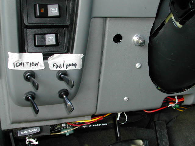

Lets see if I can get a shot of my push button switch
Pete, is that your sport or the Limited? Did you do that for the 5.0 conversion? How did you wire it up?
On a side note, how is good old Macomb? You ever join a Fraternity?
Dave
That's in the 91 sport... got the 5.0 in there... it goes from the battery, to the switch to the starter solinoid.

my friend has one in his ricer... it is rigged up so that the key must be in the on position, and he must push the switch to start it... he did with the key so people coudnt just jump in his car and drive it away... it is an illuminted switch that is about an inch in diameter and says "Engine Start" or something like that on it.....
Maybe if I'm lucky it'll run this summer... It's getting there really slowly. My ignition is all fubared... The key is stuck in the ignition, so that stays in there, only to run things like lights, heater radio wipers etc... Other than that, I've got the starter, fuel pump and ignition switched on their own.
