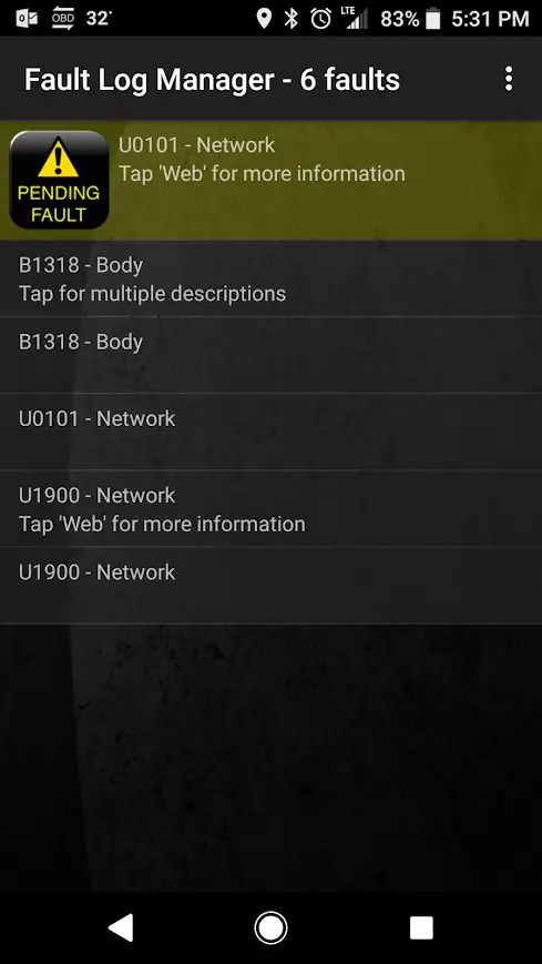

I got home and went to drive it up a slight hill to my garage, and it really didn't want to go up the hill. My wife told me the front wheels were skidding on the ground (it's icy out right now) instead of spinning or turning. I kicked it into 4H, and pulled gently up to the garage, and it seemed down on power. Grabbed the Bluetooth scan tool and plugged it in before shutting it off, and this is what we got:
So, conventional wisdom tells us this is probably coil packs, and at 140K miles, it probably is time for a set. After a restart, there was no more wrench light, no more Trac light, and the engine had full power.

Im not sure where you are getting coil packs? The only code I see there of concern is B1318, which all I can find is "battery voltage low" at the module?
Personally, based on your description, I would look for chafed wires or bad grounds first, then I would suspect the ABS system based on barking tires and the fact that the fronts were skidding up your driveway, maybe the brakes were holding them back?
Of course this is all just opinion, im no expert.
Hmm, well, then I guess the coil packs are worth looking at. I just discounted the U1900 because that can be set simply by plugging in a reader while the engine is running, which he said he did....

I installed Forscan on my laptop last night, and started playing around PIDS, and pulled up Mode 6 data. Interestingly, it has a function where it records the last ten drive cycles, and it showed a lot of misfiring on all but cylinder 1. So, I pulled all of the coils, and all but cylinder 1 were factory coils, and they all had blistered tops. Cylinder 5's coil had a physical crack right where the connector was molded to the main body of the coil. Cylinder 1's coil was a Masterpro (O' Reilly brand) that some owner years before myself or the previous owner had installed, and it still appeared serviceable, and passed an ohm check.

The battery is 5 weeks old, and I could find no other voltage related issues. The alternator is putting out 13.9 VDC at idle as well. I'm pretty sure the B1318 was set 5 weeks ago when we were cranking on it in the shop, and the battery got cooked, and went severely under voltage.
