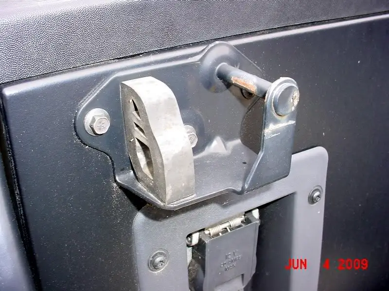

1) OMG don't glue it! Your Ford dealer can get you a retainer clip, surely only a couple bucks.
2) If all else fails you can crawl into the bed and remove the 3 bolts that hold the brackets to the bed or the four bolts that hold the latch to the cover.
Thank you ncranchero,
1) I have an appointment to address the cruise control recall next Saturday (I have been putting it off because I never use my cruise control) so I will inquire about the retainer clip.
2) I don't relish the idea of paying someone to crawl under there and unscrew those bolts.
Great photos also!...
