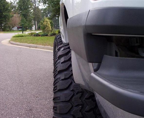

Here is a picture of my old Eagle Alloys wheels with some 12.50 TrXus M/Ts. The specs on the wheel are 15x8, -30mm Offset, and 3.25" (3-1/4") backspacing. I think they looked perfect. This is to show you what -30mm offset looks like.
-Drew
