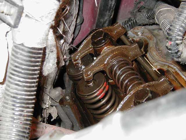

Here's what you can look for. If you look at the rocker arm that's above the spring with the red paint on it, you will notice the arm isn't touching the top of the valve. (Hence the valve clatter) In this picture I was able to move that rocker by hand back and forth. What you may have to do is crank your engine over by hand to have the engine go through it's complete cycle. Then you'll be able to find the loose rocker arms as the engine turns. (Obviously disconnect the battery and follow all saftey procedures when turning the engine by hand!)
