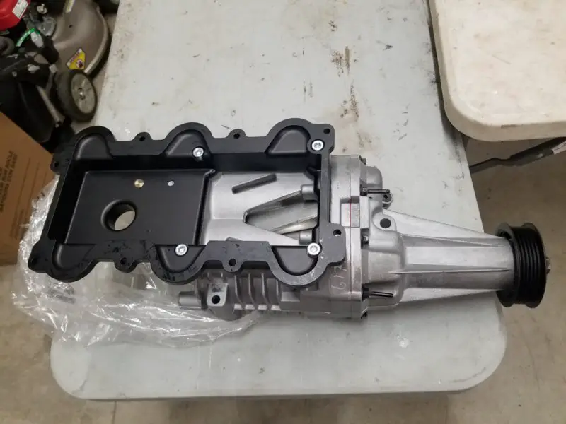

I got the top plate attached to the supercharger and got the pulley installed. I'm hoping to tear the truck apart over the holiday weekend and have a Supercharged Sport Trac by the weekend!
Be sure to put the whole intake together before it's on the truck all the brass fittings and most importantly use liquid thread sealer or you most likely have vacuum leaks

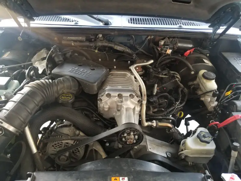

I finished the installation today with the existing IAT wiring. I received a response from Modd saying he's out of the office but will send me the wiring instructions for the new one in a few days and then I'll just splice it in. Right now it's just running off temp at the MAF.
The ECU was kind of funky (high idle) from miles 3-11 and it threw a code but she settled in after that and I cleared the code and put another 15 miles on her without a problem.
I'll post pics tomorrow.
So far, I've been pretty easy on the gas but the power seems smooth but certainly not overwhelmingly significant. I hope to get a little better return for my money when I can get on the pedal a little better.

Finally got the IAT wired in and flipped the EGR to give a little more clearance. She finished off really clean. Great noise and noticable improvement in power.
I can spin the tires all the way up a steep dirt road by my house and rooster tail a donut at the top!
I don't know if I'll bump it up to 5.5lbs boost or just leave it at 3.5lbs. The Modd kit was excellent and easy to install. The parts are high quality and had great fitment and tight tolerances.
