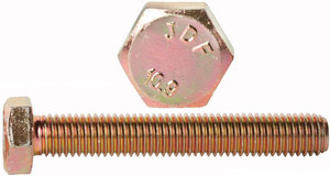

Before going to the dealership and going by the info swshawaii gave on bolt size I did check FASTENAL's website and the 2 closest matches to factory length were these.
Part number 11114572 M12-1.75 x 70mm DIN 933 Class 10.9 Yellow Zinc Hex Cap Screw
and
Part number 0127165 M12-1.75 x 65mm DIN 933 Class 10.9 Plain Finish Hex Cap Screw
