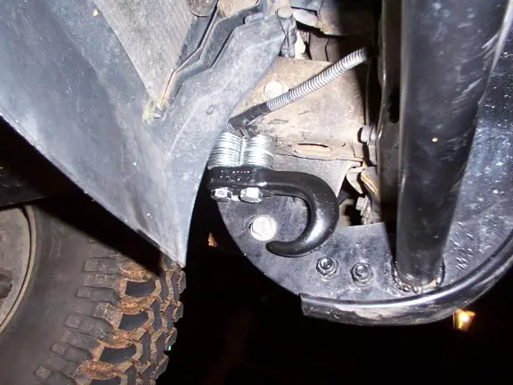

i got a brushguard on the front as wel. only way i can get hook to fit is to drill a hole all the way through the frame to the other side and bolt to there. i also have a ton of spacers and that has worked to me. the hooks are kinda close to the brush guard but they will work. there is enought room to fit a tow strap onto it.
here's how i did mine:
bolt goes threw the intire frame! it was a $%@$# to drill through but i did it!
well i thought it through and decided to go for it. they are tightened to the max and will test it soon to see how they work. the washers are the thickest ones i could find.
if it doesn't work what should i do?
also i had to add alot of spacers to clear the bumper in the case if i get pulled by a tall truck it will not be touching my bumper.
